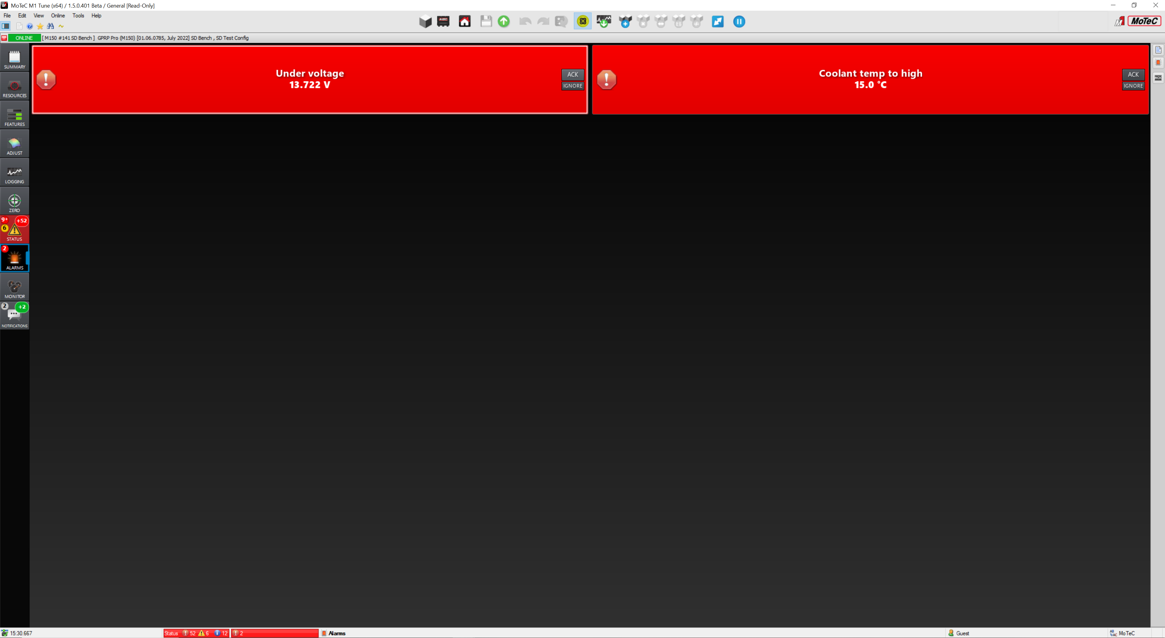

Alarms
This view will display any active alarms while online with an ECU and can be selected using
Shift+F3.
Note: Alarm settings are saved within the Workspace on the connected
PC.
From the buttons on the right side of the screen you can review the Alarms Event Log, Edit the Alarms as well as Acknowledge All active Alarms.
Pressing the K key will also acknowledge all alarms.
To acknowledge individual alarms us the buttons on the alarm:
Acknowledge this alarm.
Ignore this alarm for the entire session.
