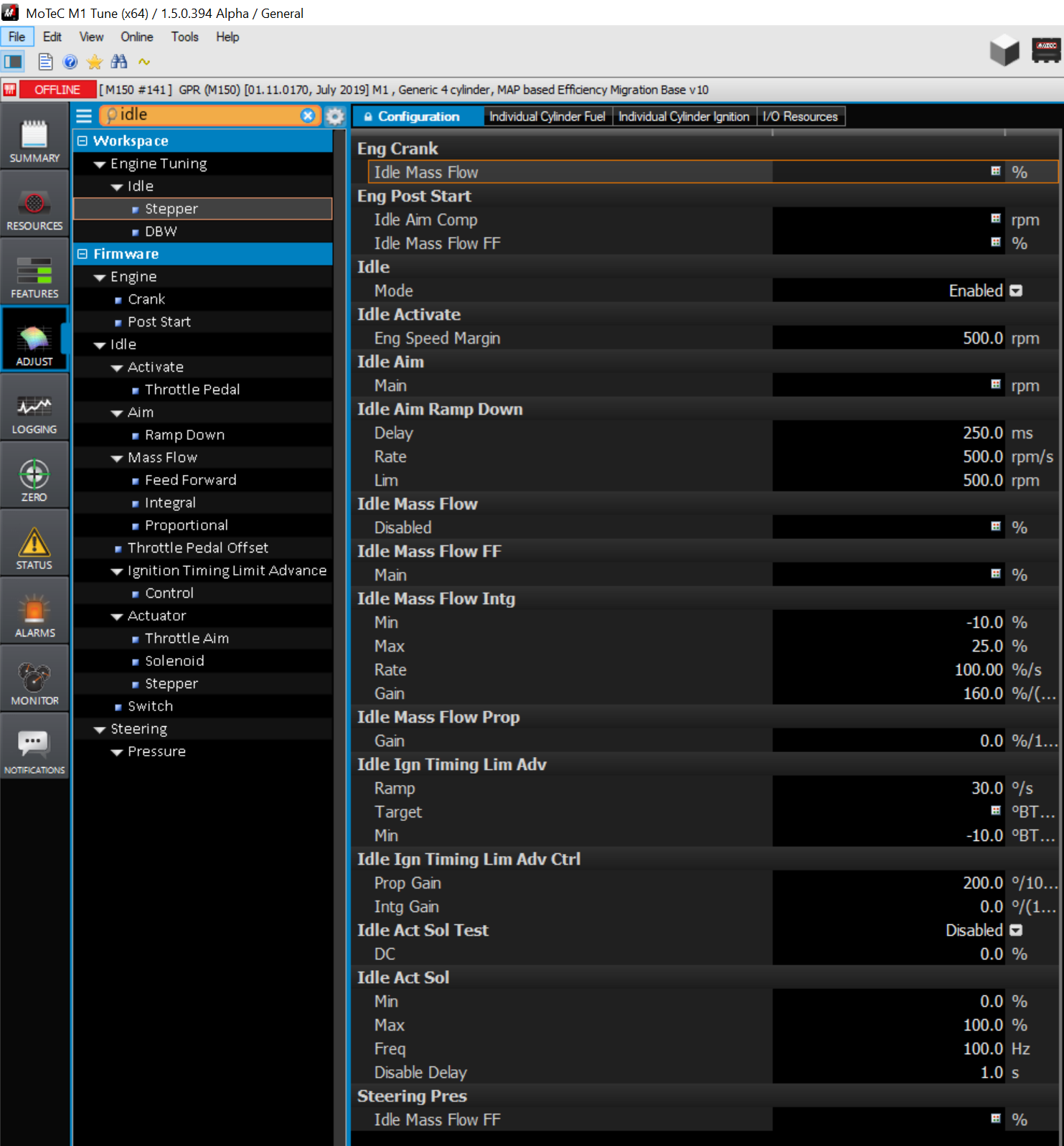

Find
Type a key word into the Find search bar above the Adjust tree to find the parameter required.
In the example below the keyword idle is entered, Tune has looked within the Adjust groups under the Workspace header and found the first instance of the word followed by instances in the Configuration Worksheet.
Tune has also found the word Idle in all places under the Firmware header
Note: Parameters not
found in the worksheets will show up under the firmware header at the bottom of the Adjust
tree.
