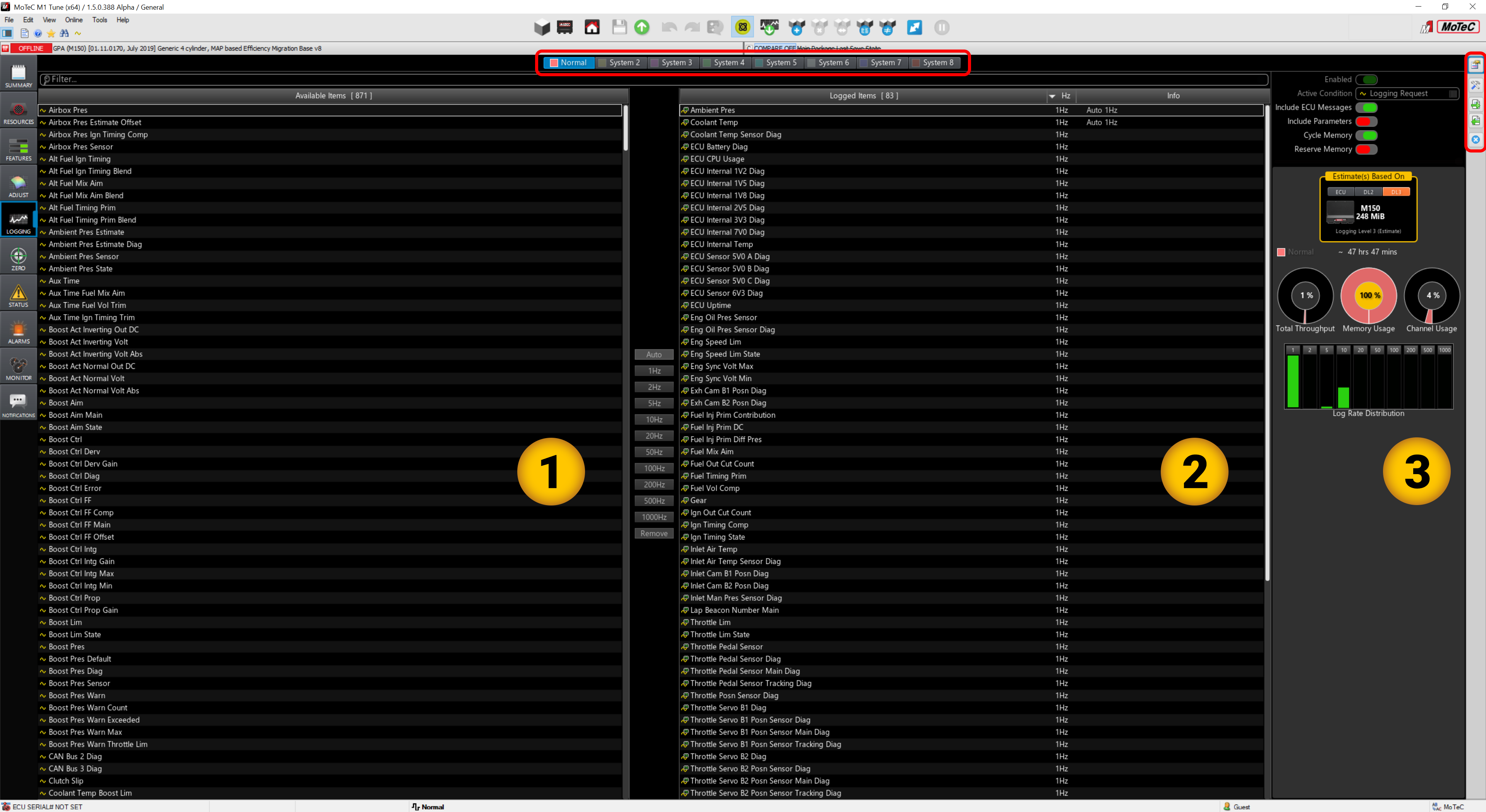

- Available Items section (channels, parameters and resources).
- Logged Items section. The default shows the required diagnostic channels.
- Properties section. Slider switches and Logging Statistics. See Logging Statistics

Logging System selection
Select the Logging system to view. Normal is setup when M1 Tune is started, the other systems are configured as required. See Logging Configuration
