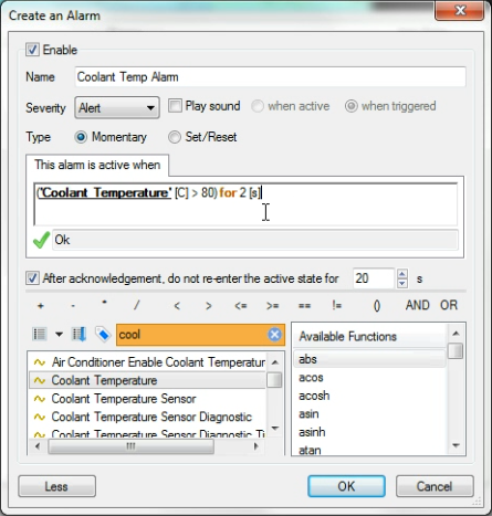

  • Enter the required alarm conditions, in the example below the Coolant Temp Alarm will trigger when the coolant temperature exceeds 80 degrees for 2 seconds.
    Note: Alarm conditions can contain a special statement beginning with the word for, this is used to specify how long a condition must hold true before it is evaluated as true. The example in figure 1 uses the special statement, for 2 [s]. Correct syntax requires the preceding condition to be enclosed in parenthesis. The unit default is seconds, but any of the time units defined in the Quantities and Units can be used.

Figure 1. Example Creation of an alarm
