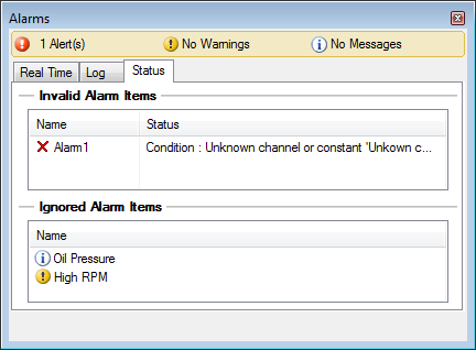

Alarm Status
Invalid Alarm Items
If an alarm is created that is invalid it will display on the Status tab as shown below.
Figure 1. Example Status Tab
Examples of invalid alarms could be:
  • An incomplete or erroneous alarm.
  • An alarm that requires a channel that is not available in the current Package.
Ignored Alarm Items
Ignored alarm items are not triggered and they do not appear on the Real Time tab or as a notification on the Status Bar.as seen above the High RPM and Oil Pressure alarms are in an ignore state. Double click the entry to remove the Ignore status and return the alarm to the Real Time tab.
