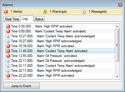

Alarm Log and Jump to Event
The Log tab on the Alarms Event Log provides a history of all alarm events, see below. It also provides a means to examine an alarm event on the Time Graph.
Jump to Event
To jump to an event:
  1. Select the Pause button to pause the Time Graph.
  2. In the Log tab, select the desired event.
  3. Double-click or select the Jump to Event button.
    The cursor is positioned on the Time Graph at the time that the event took place.
