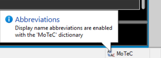

To enable the different dictionary, Right click at the bottom right of the screen.

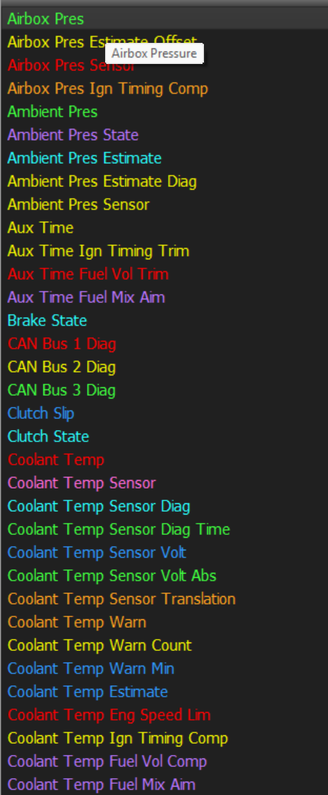

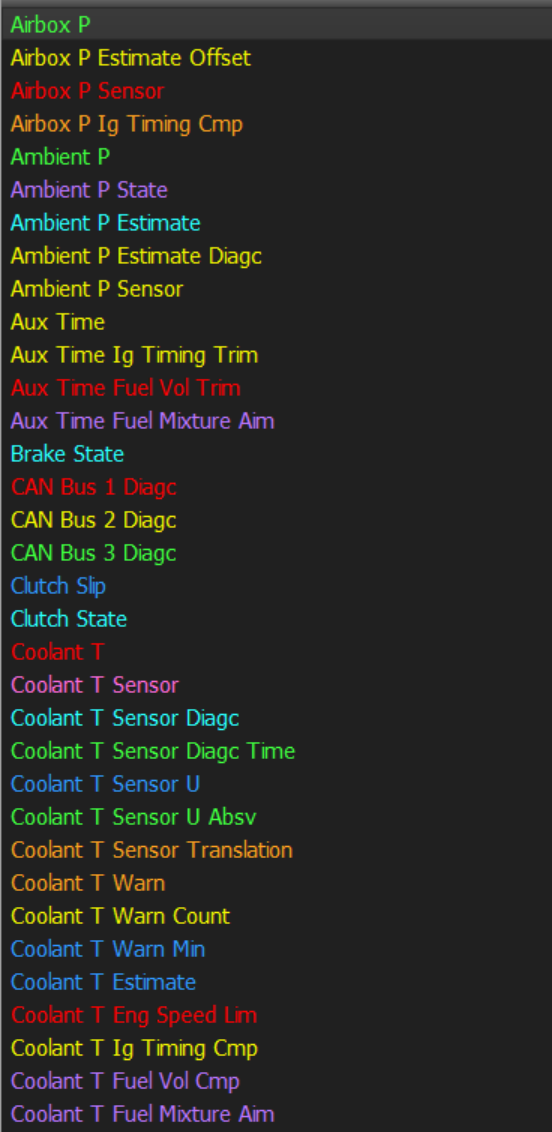

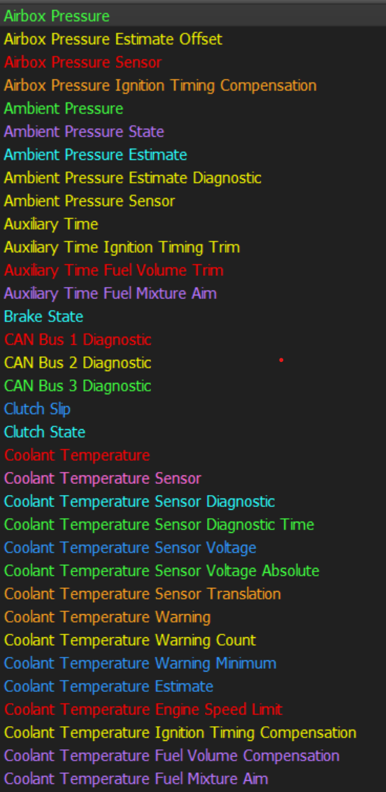

Table 1. Example of abbreviations
Firmware MoTeC AUTOSAR

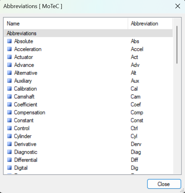

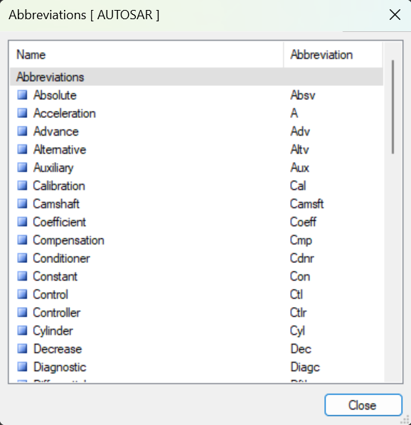

An abbreviation list for the MoTeC and AUTOSAR dictionary may be viewed by selecting Tools > Show Abbreviations...
Table 2. Example of Abbreviation lists
MoTeC AUTOSAR
