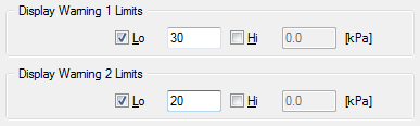

Oil pressure example

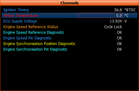

If an oil pressure sensor is setup with a low limit of 100kPa, as shown here...
...then in any location within M1 Tune where the oil pressure is shown, the value displays in red rather than in the default colour. This is shown below in the oil pressure Bar Graph (for Bar Graphs the bar itself is red rather than the number) and in the Channel List.
