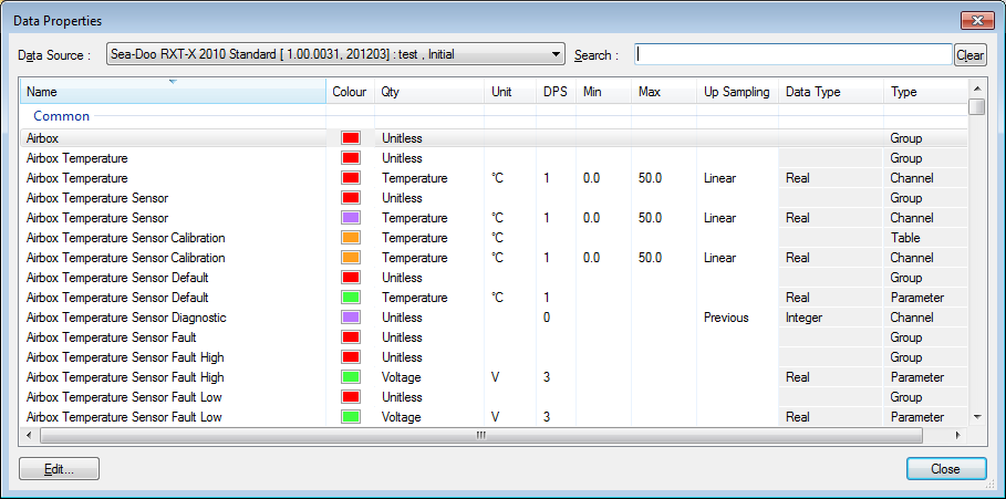

Within M1 Tune, the user has the option to configure any channel to suit their local requirements.
The Data Properties window shows all channels in use by the current Package, and their property settings.
Note: These channel properties are global, and any change that is made will reflect across the entire application.
Figure 1. Example Data Properties window
