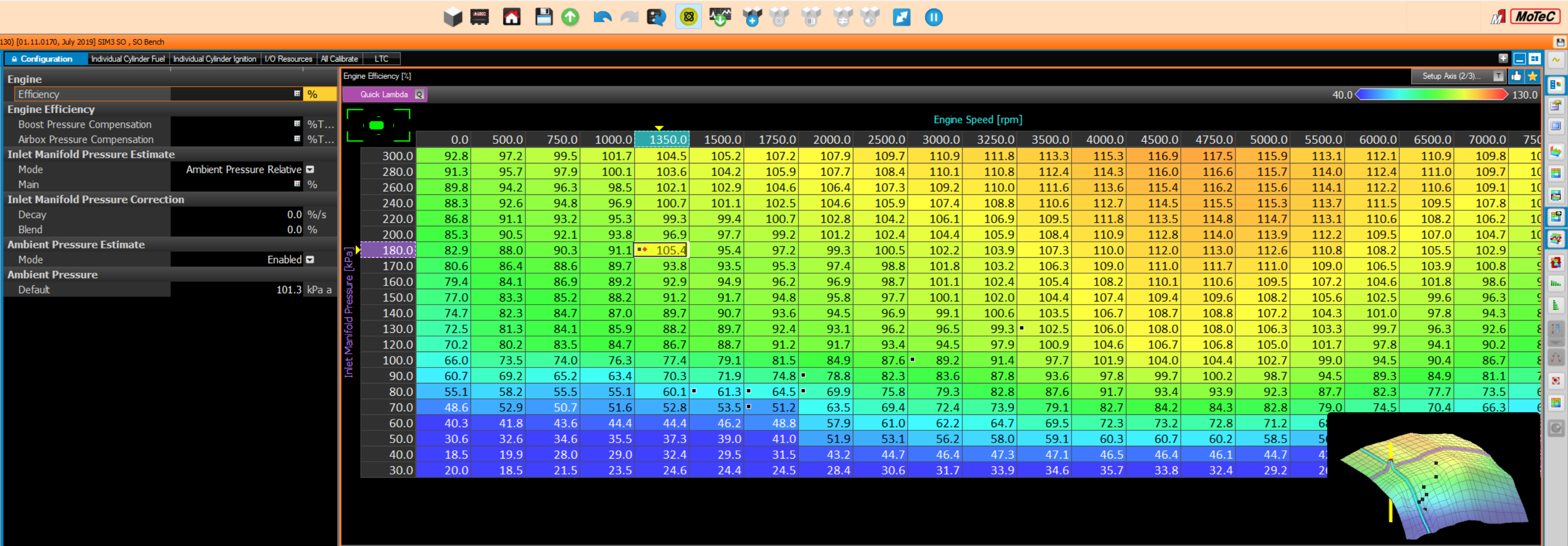

The image below shows the Engine Efficiency calibration in focus.
With the engine running steady within a cell select Q this will calibrate the sell based on Exh Lambda Normalised.

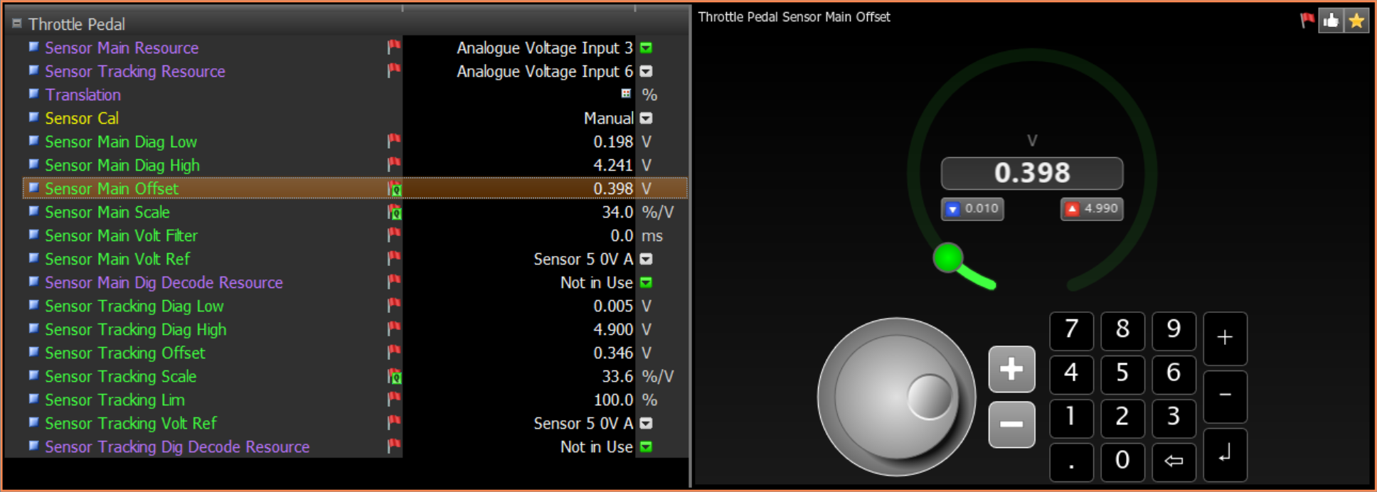

The image below shows the Throttle Pedal Sensor Main Offset calibration in focus.
With the throttle pedal in the closed position select Q the pedals low position will be calibrated.
