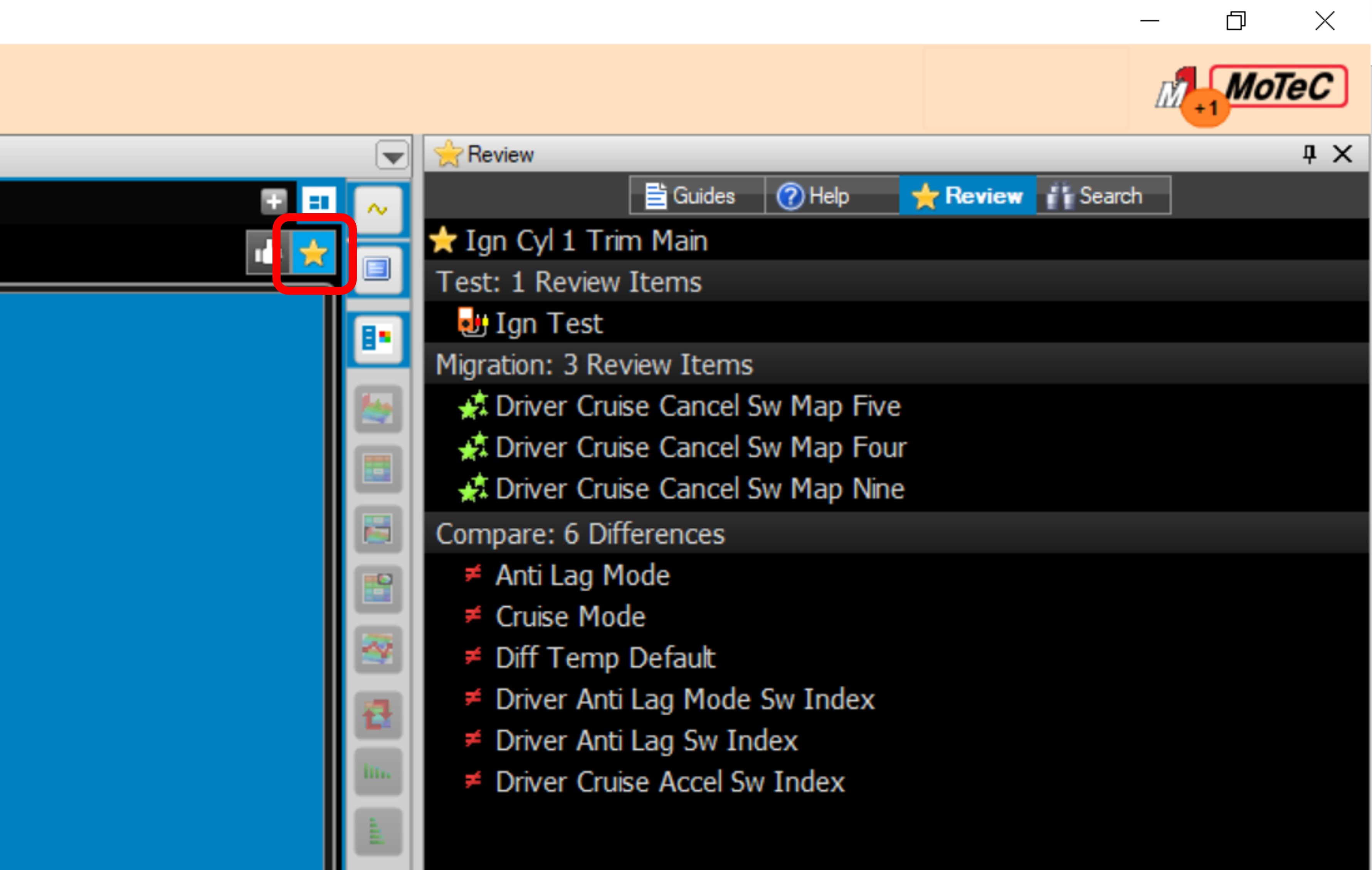

  • General Review allows the user to mark parameters for review later in the engine tuning process, or for an easier way to mark parameters that need validation when working remotely or in a team environment as the marking of these parameters is stored in the ECU.

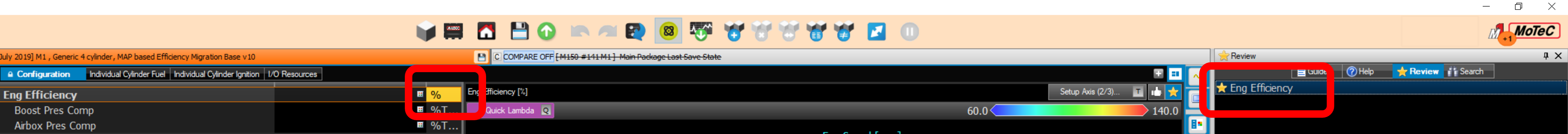

    To mark an item for review, select the parameter or calibration table, select the yellow star on the top right corner of the worksheet.
    When the item is marked for review, the unit’s column will be highlighted in yellow as well as being added to the review checklist.
  • Test Mode Review provides a reminder of any test modes that are currently active. The Test Mode review item will be removed when the test mode is Disabled.
  • Compare Differences Review as changes are made to the configuration the compare differences appear in the Review list. When the changes are saved the Compare list is removed.
    Note: Compare Package with last saved state can be turned off. Select Tools > Options... > General un tick Automatically update "Compare Package" with last saved state.
  • Migration Review during package migration the Migration Summary will be shown, there is the option to mark items for review. The selected items will appear in the Review list.
    Note: To un mark a Migration Review item, select the yellow star on the top right corner of the worksheet.
  • Invalid Item Review invalid items will show in the Review list when a value is outside the Min or Max settings.
