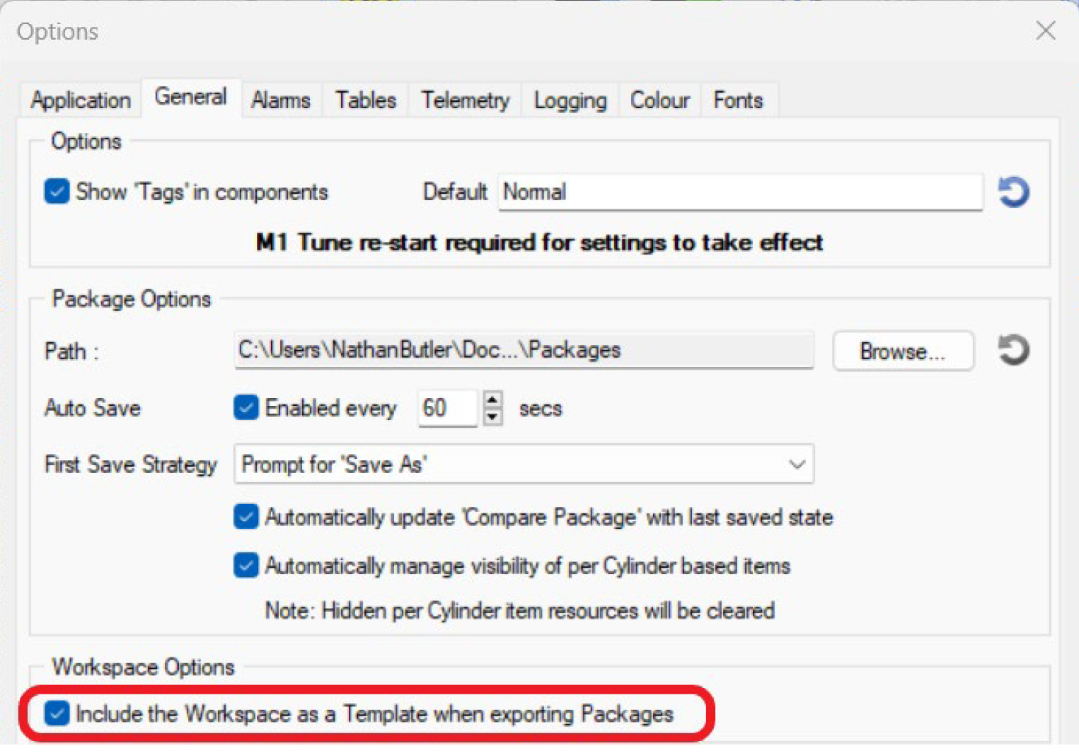

When a workspace is to be paired with a firmware package, it may be exported from M1 Tune with the package into the package archive.
This allows the workspace to be installed on installation of a package when distributed.
NOTE:
  • The installed workspace has a name match for the firmware package.
  • The workspace will be installed as an MTF file in the package folder of the templates directory, located in My Documents.
To enable this functionality Include the Workspace as a Template when exported Packages button needs to be checked on,
select Tools > Options... > General
