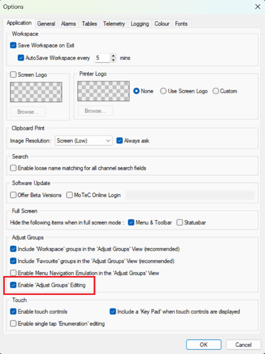

The ability to edit must be enabled through the options menu.
Select Tools > Options... > Application tab.
Enable ‘Adjust Groups’ Editing, tick the box.
The gear wheel will be visible at the top of the adjust tree.

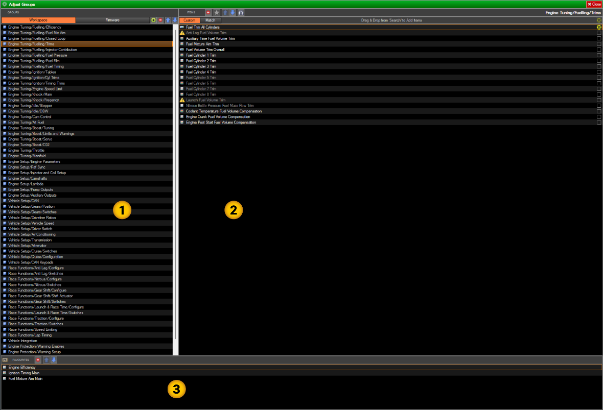

To edit the Adjust Tree click the gear wheel icon, the editing pane opens.
  1. The Workspace configuration section
  2. The parameters configuration section
  3. The favourites configuration section

The Workspace configuration section ⓵
Use these buttons to toggle between Firmware and Adjust group lists.

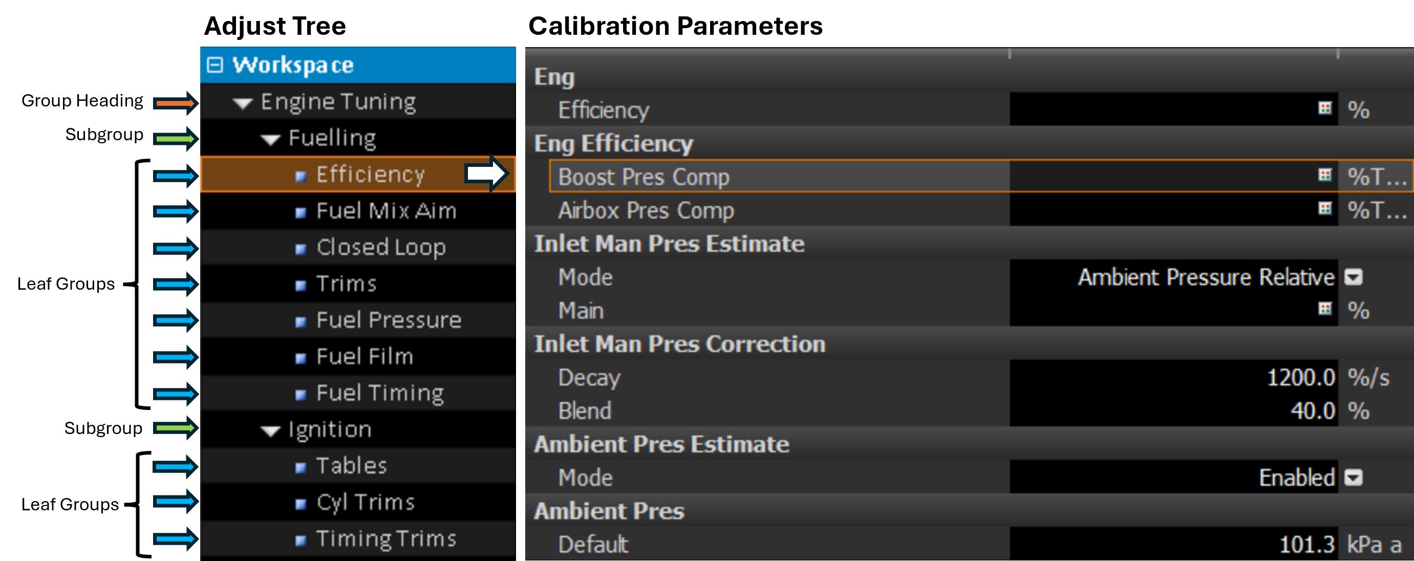

Defining the Ordering in Adjust Groups
The order of each group shown in the Workspace list is the order that the group will appear under the Workspace header in the Adjust Tree.
When customising the adjust groups or defining a custom workspace from scratch to suit a custom firmware, there are several rules that need to be adhered to, to successfully build an Adjust tree.
  • To make subgroups under a group heading, a forward slash is used.
  • When subgroups are utilised, no calibration parameters are to be placed under the group heading.
  • There are no limits to the number of subgroups that can be populated under a group heading.
  • It is recommended not to exceed 4 layers of depth, which is the limit for the firmware groups.
An example of 4 layers of depth is EngineTuning / Fuelling / Efficiency / Boost Pres Comp.
The parameters configuration section ⓶
Use these buttons to toggle between Custom and Match.

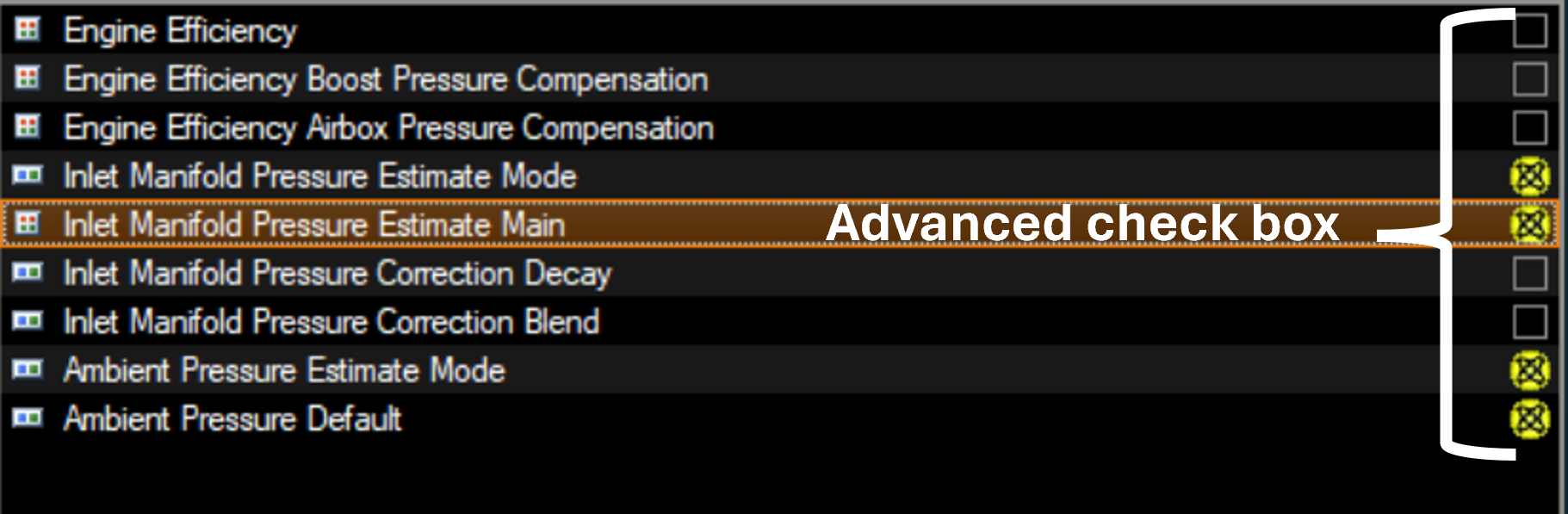

Advanced filtering
To assign the Advanced filtering status to a configuration parameter, the advance check box will need to be enabled.
Note: If every configuration parameter in an Adjust group has advanced filtering enabled then the group will only be seen when the Advance filter button is checked ON in the task bar.
The favourites configuration section ⓷
The configuration parameters selected here will populate under the Favourites header in the adjust tree.
Click the binocular button the search at the far right of screen will be available to drag and drop the required parameters into the Favorites section.
The configuration parameters can be re ordered using the up and down buttons.
Use the button to remove parameters.
