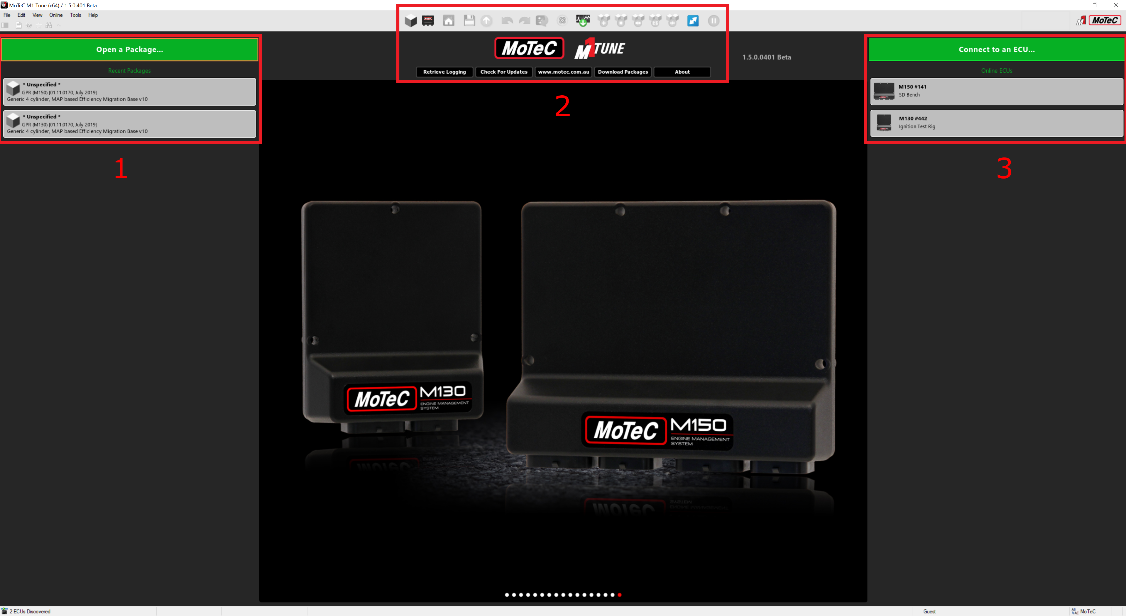

Overview of Interface
The home screen centres around a quick launch layout as shown below:
The home screen layout has three main sections.
  1. On the left side of screen are the recently used Packages, click on a package to open it.
    • Clicking on the green button Open a Package... will launch the Open Packages dialogue.
    • Newly installed Packages will be highlighted yellow.
    • A maximum of 7 Packages will be shown.
  2. Centre of the screen are the 5 quick launch buttons select to perform the functions below:
    • Retrieve Logging quick launch retrieval of logged data.
    • Check For Updates manually check for updates for Package, workspace or software updates.
    • www. motec.com.au quick launch your default browser and navigate to the MoTeC website.
    • Download Packages quick launch your default browser and navigate to the firmware downloads page on MoTeC Online.
    • About will launch the software information pop-up.
      Open package (Ctrl + O) Open ECU (Ctrl + Shift + f8) Retrieve Logged Data from an ECU (Ctrl + F8) Toggle Full screen mode (F11)
  3. On the right side of screen are the Online ECU's, any M1 ECU's discovered will appear. This list will automatically update, click on an ECU to connect to it.
    • Clicking on the green button Connect to an ECU... will launch the ECU Select dialogue.
