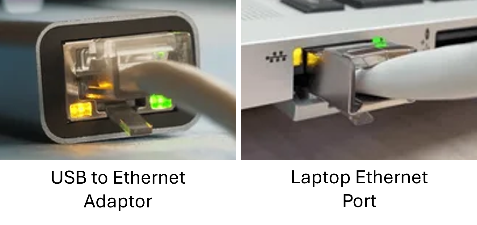

  1. Ethernet ports may include LED indicator lights. Check if they are lit when the ECU is plugged in and powered ON, they normally flicker, indicating data traffic on the cable.
    Figure 1. Example Ethernet LED's on a laptop or USB to Ethernet adaptor
    If the ECU is powered ON and the lights stay OFF, it most likely indicates an Ethernet wiring issue.

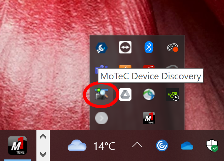

    1. Temporarily disable, turn off, or uninstall any anti-virus applications.
    2. Close M1 Tune and ensure that the MoTeC Device Discovery service is also stopped. To check if MoTeC Device Discovery is running, display the active services as shown in the following image. If the MoTeC Device Discovery icon is shown (as circled below), right-click on it and select Exit.
    3. Restart M1 Tune and attempt to establish communications with the ECU.
      Note: If turning off or uninstalling your anti-virus or firewall fixes the problem, then your anti-virus or firewall application must be configured to allow the MoTeC ECU to communicate normally.
