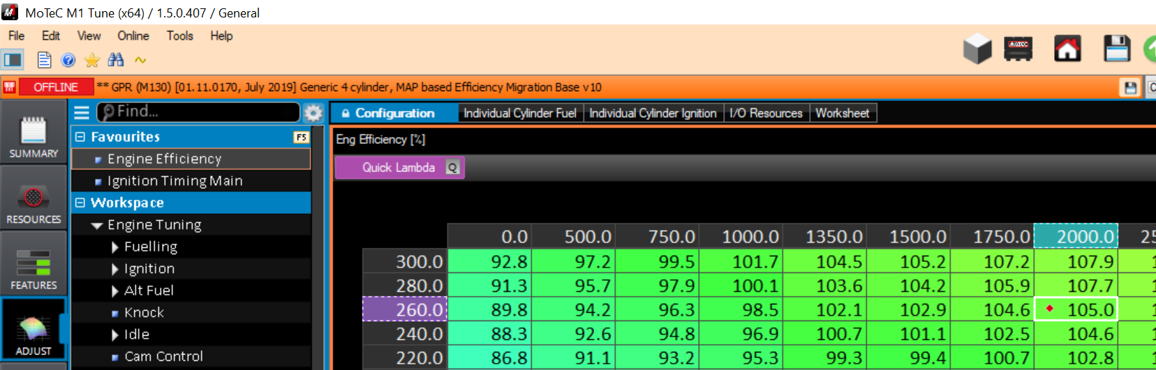

Packages may be configured Online or Offline from the ECU, when changes are made M1 Tune will prompt to Save the changes.
The banner containing the package name will turn Orange prompting to Save the changes.

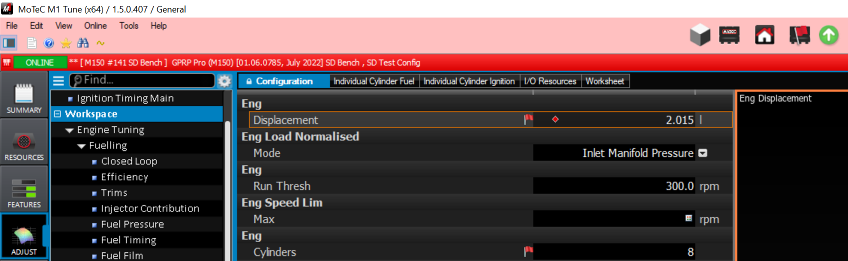

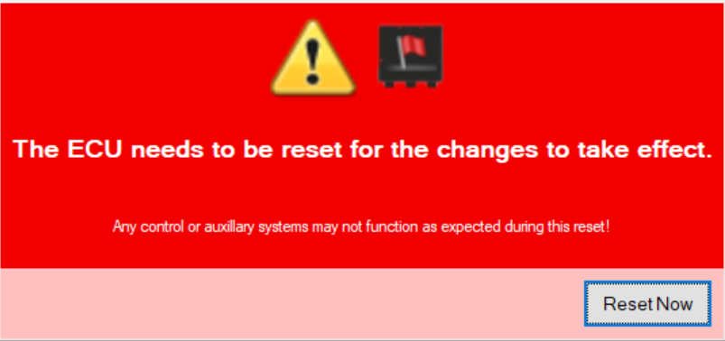

When Online with an ECU, parameters that have a Red flag require an ECU reset when saving. When the firmware resets, if the engine is running it will cut out momentarily.
The banner containing the package name will turn Red prompting to Save the changes and warning of the ECU reset.
When Save has been selected a secondary ECU reset warning will appear, select Rest Now to Reset the ECU.

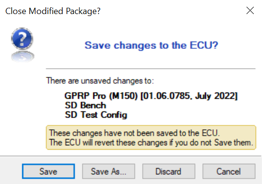

The Closed Modified Package window will appear when a Save is pending:
Reasons window appears Choose required action
