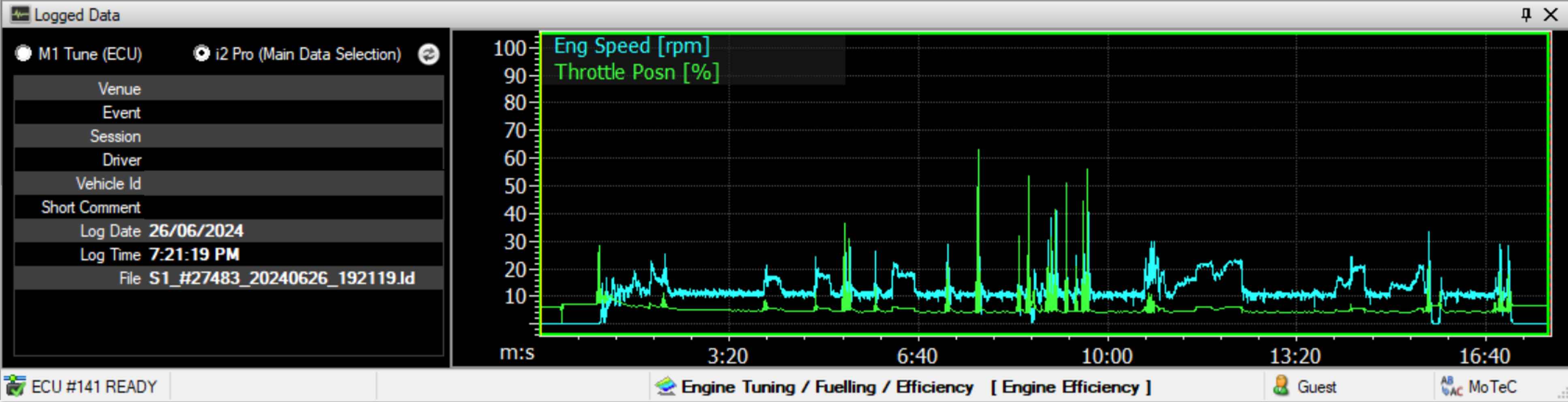

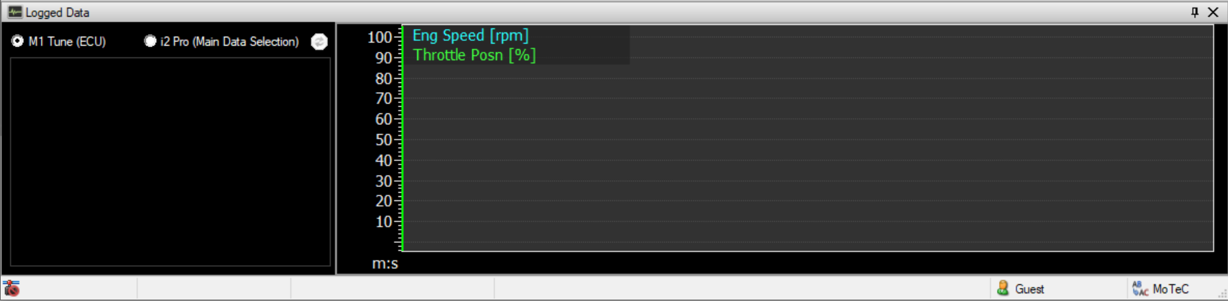

  2. Press F8. The Logged Data view will appear at the bottom of the screen.
  3. Select i2 Pro (Main Data Selection). The i2 Pro application will launch.
  4. Open the desired file in the i2 Pro application.
  5. The logged data file will populate the Time Graph and the Logged Data view. The logged data file details appear to the left of the Logged Data view.
    Note: The Logged Data view shows the default channels Engine Speed & Throttle Position other channels may be dragged into the Logged Data view.

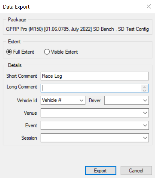

The ECU telemetry data from the time graph may now be exported into an ld file. When the ECU is correctly enabled a log file containing all ECU logged channels is possible for export.
The exported ld file can then be opened in i2 Pro for import into M1 Tune. See Data Import from i2 Pro
The ability to view telemetry data with all channels may help in instances where a log set has not been configured optimally, or an unexpected behaviour occurs during tuning allowing for issues to be captured.
To export Select File > Export Data...
The requirements for export are:
  • The connected ECU has a PC activation for ECUs with level 1 logging.
  • The connected ECU has at least level 2 logging.
Note:
  • The data in the exported LD file will have a telemetry rate up to 50hz.
  • When the ECU has Pro Analysis enabled, the exported LD file will be an I2 Pro log file.
  • To view Standard i2 log files in i2 Pro, the Standard logging in i2 activation is required.
